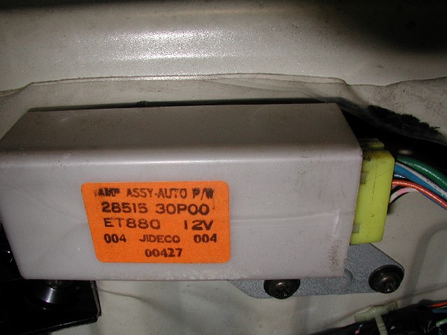

Message I had a similar problem with my 94TT.
Driver's side window would work partially if you kept hitting the switch, then it quit all together.
Since I had two Z cars at the time, I tried switching this electrical box and it worked. I found a used one for cheap.
The switch is mounted upside down. I flipped the photo.
No guarantee, but it might solve your problem. Sorry, I can't remember the name of the switch.
